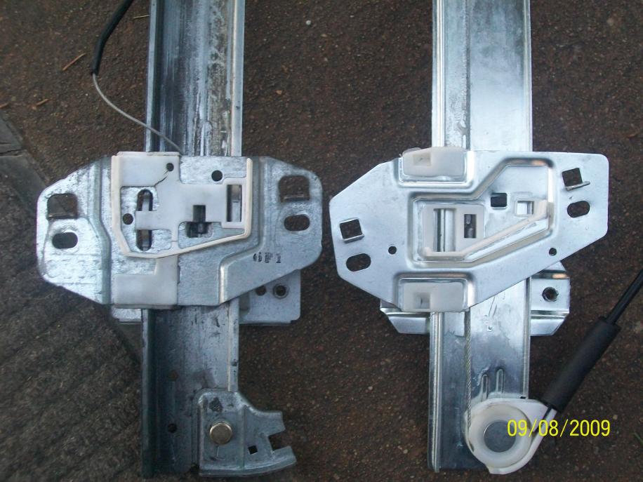

Thanks, seamusNH. I got the old window regulator out and as you said the plastic pieces are mangled. I went to put in the new one that I ordered off the internet. But the sliding piece that attaches to the window is the wrong shape. All the parts suppliers have the part number as A462904 and the picture looks like the one they sent me but it's different from the one I took out of the car. Did you run into this at all? See pic on next posting.

Here is a pic of the two parts, the left one being the one I took from the car.
