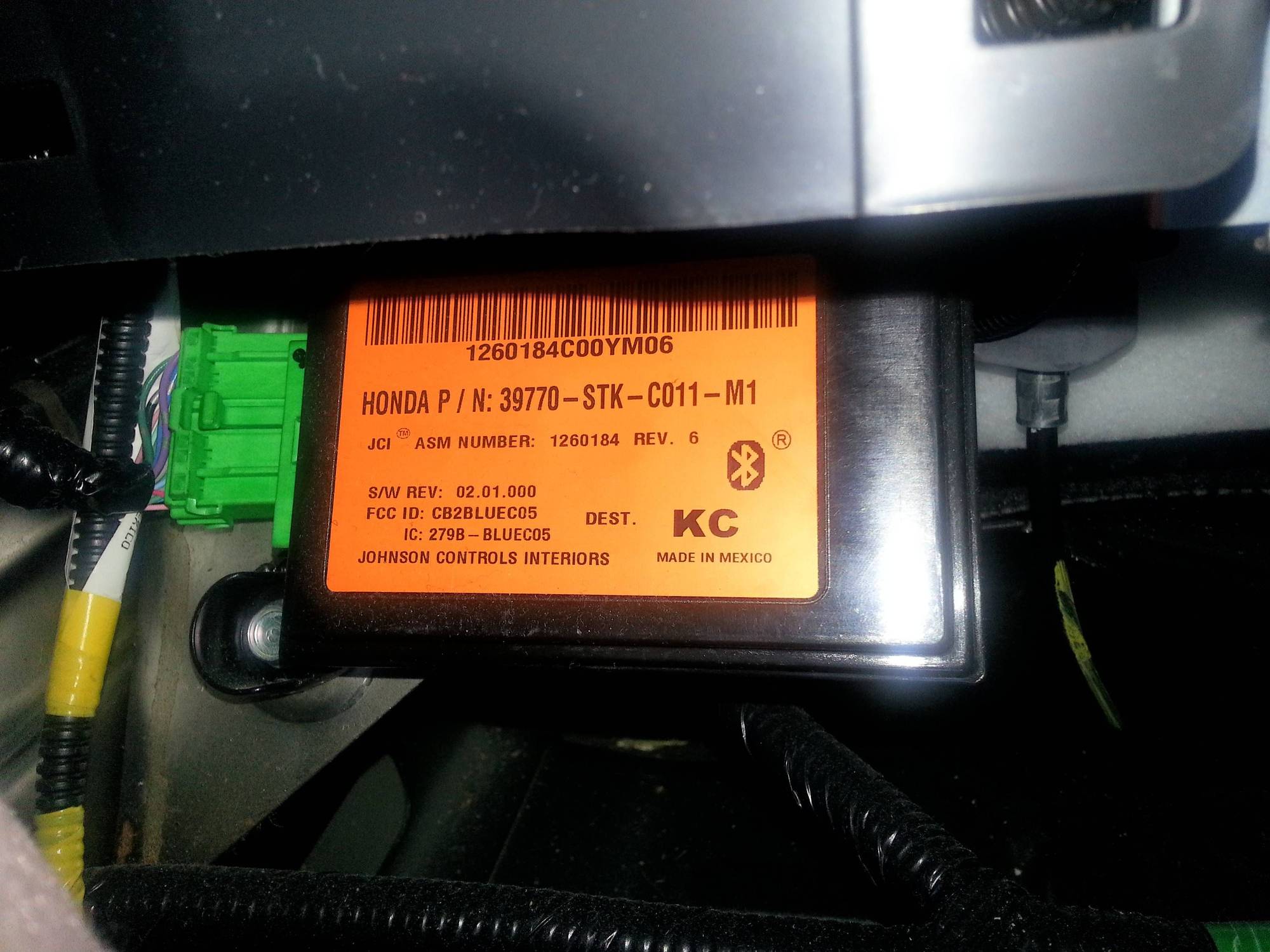

By the way the HFL module in a 2007 RDX Tech, and I assume other models as well, is on the passenger side of the center console. You will need to remove the DVD cover and carefully pull back the carpeting/plastic on the console (it is held by clips).. The picture shows what it looks like. BUT DO NOT NECESSARILY order what is shown because there are indications it is from a Canadian RDX.

I unplugged the HFL yesterday and that solved it!! I was able to go to the gym this morning with no issues!
