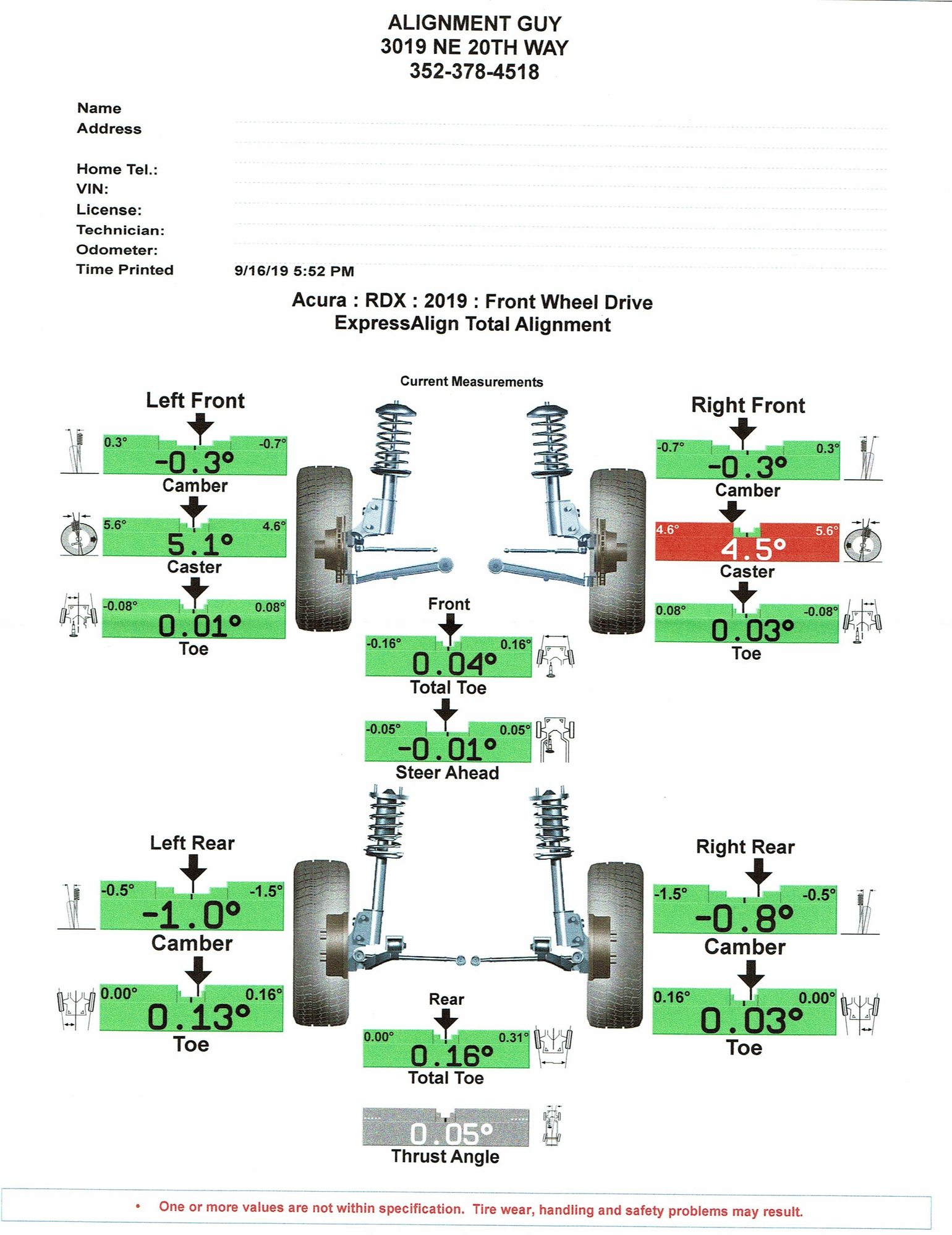

Days old 2020 rdx a-spec. I like the car but I don't like how it handles on the highway. It wanders back and forth requiring constant correction whether it's me or lane assist driving. I would like to know what the alignment specs should be before I ask Acura to measure them....toe, caster, etc

these are the after numbers. The tech didn't yet have the 2020 numbers so he used 2019.
It ended up being toe-in. The alignment guy reset it to a bit "toe out" and removed some
air from the right front tier. I knew about that part, but after he fixed both; it drives wonderfully.
It was not that far out of spec either but his changes made all the difference.
