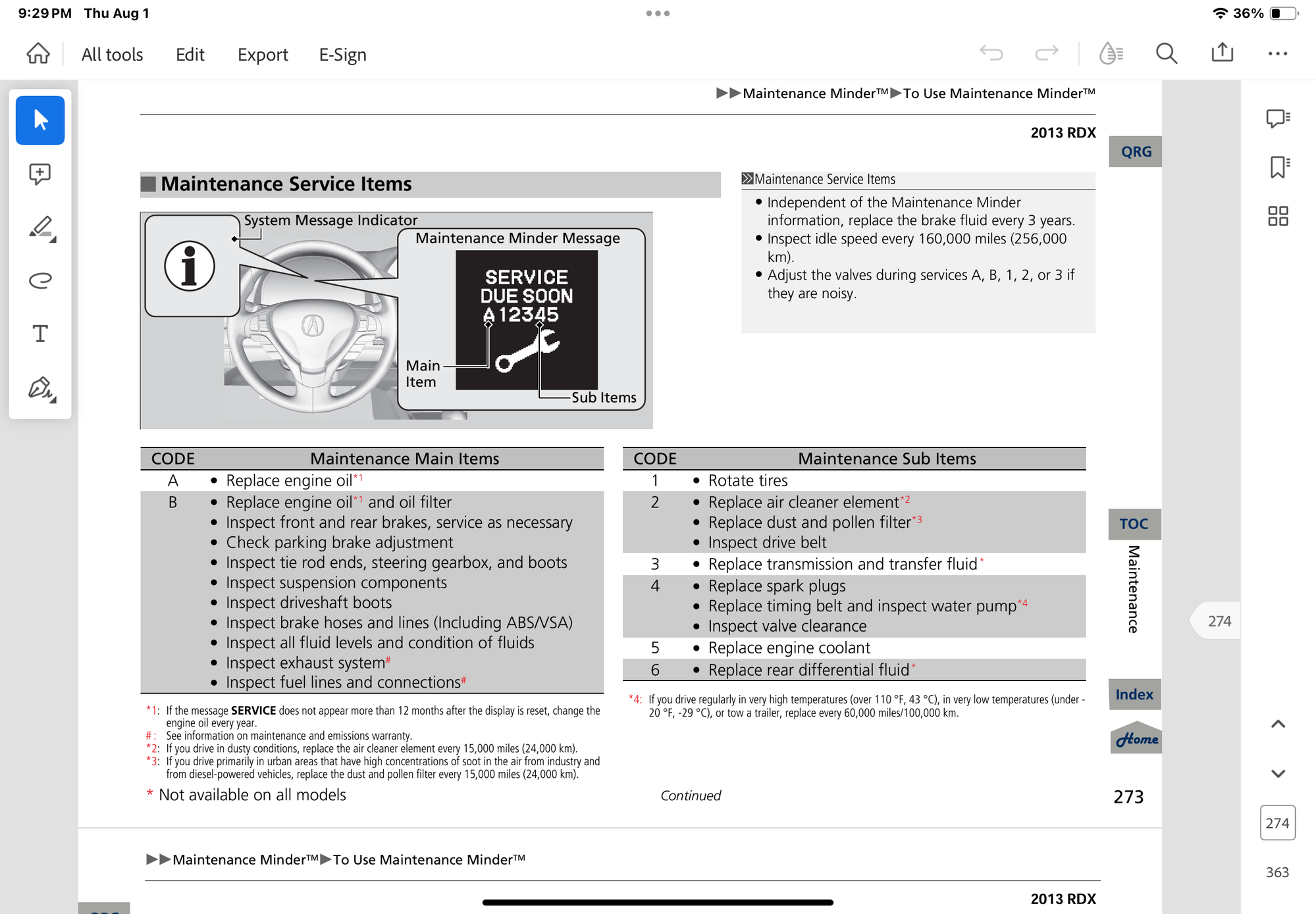

For what it may be worth, there is a PDF at 2013-2015 RDX maintenance. It should be noted that maintenance intervals for many Acura vehicles are based partly on Acura Maintenance Minder System and that may be why dealer recommendations vary. If you want info on a specific item, perhaps looking at the appropriate 2013 Accord maintenance schedule would be of help. The "maintenance minder" in the Accord is very minimal, just oil lfe as a percentage. .

The maintenance minded will display codes that tell you what maintenance should be performed when you are due for an oil change. See below. The only item that is not addressed on my 2013 RDX is the brake fluid. Speaking of oil changes. I think that Honda has you go way too far between oil changing. Over 9000 miles. I change my oil every 5,000 miles.
