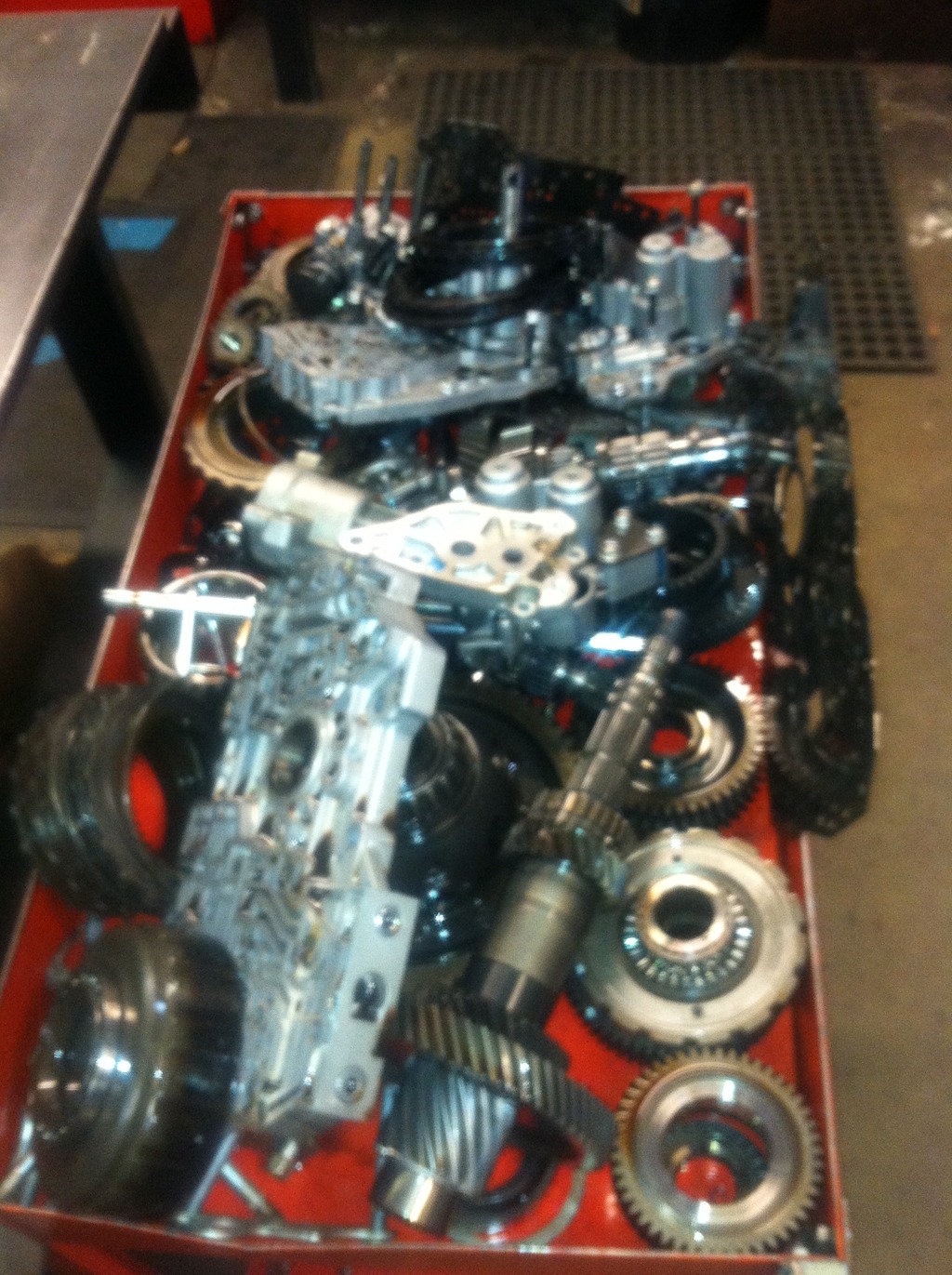

Internal components in roll tray.
Attachment 1007

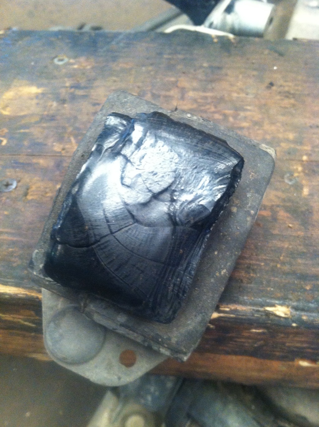

Burnt 3rd gear clutches
Attachment 1008

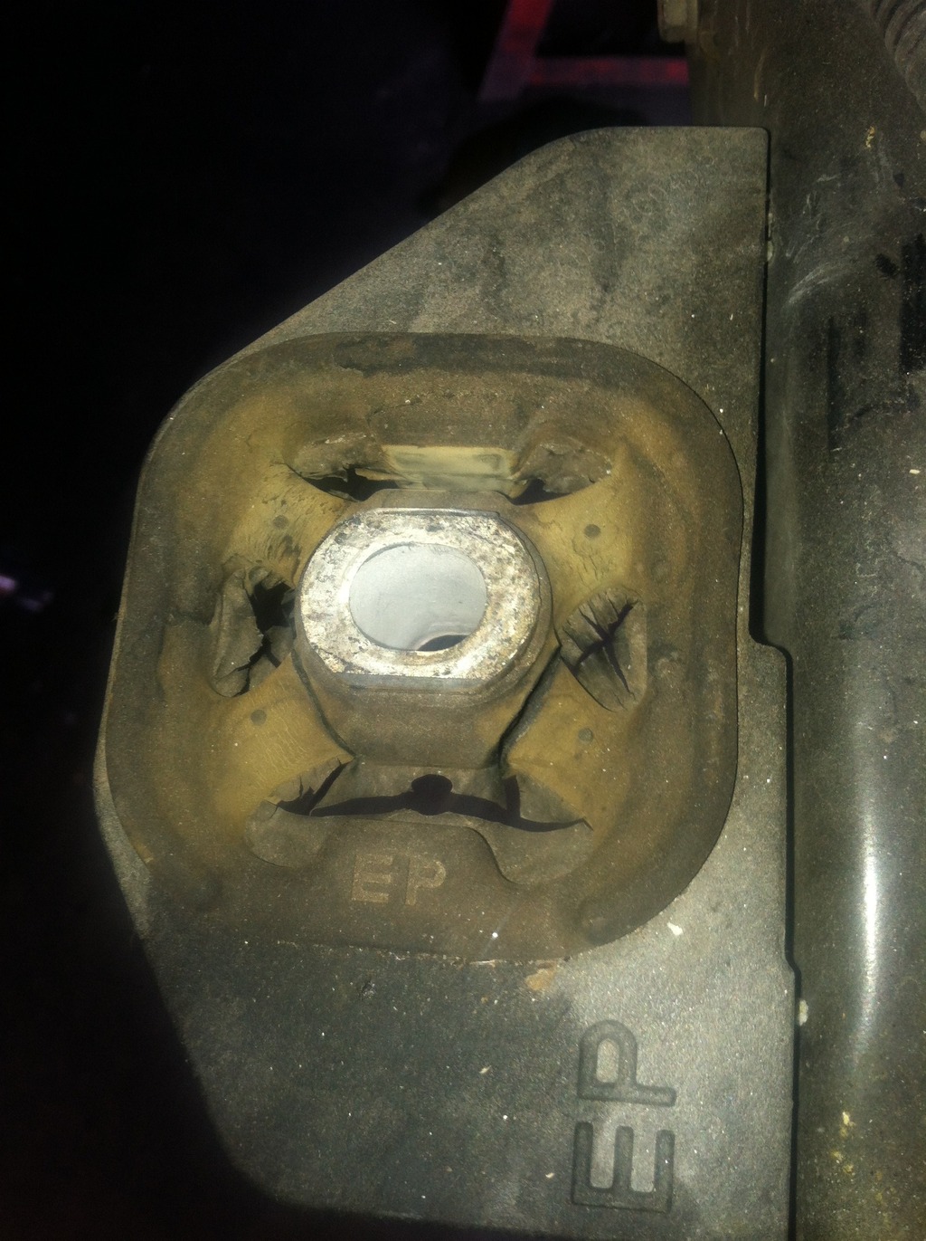

Bad transmission mounts (worn, separated or cracked)
2 on cradle 1 on frame in engine compartment
